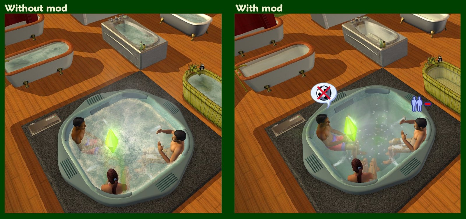

Vegan-kaktus over at MTS asked about Targas's Transparent Water Fix which had started crashing the game when you tried to select or load the large fish tank (Aquabox 60 gallon) that came with Apartment Life.  The mod was made long before that EP appeared and I thought that the internal referencing was possibly not up-to-date but that turned out not to be the problem.  In fact, logical when I actually looked at the file and found out that the mod is in reality a simple texture default replacement.
In fact, it was a very, very simple fix - at least as far as I can tell.  The problem was that the texture format of the texture causing the issue was misidentified as a Raw24Bit rather than DXT3 so the game was misreading the texture.  Literally, a one-click fix in SimPE (well, three if you count the commit and save).

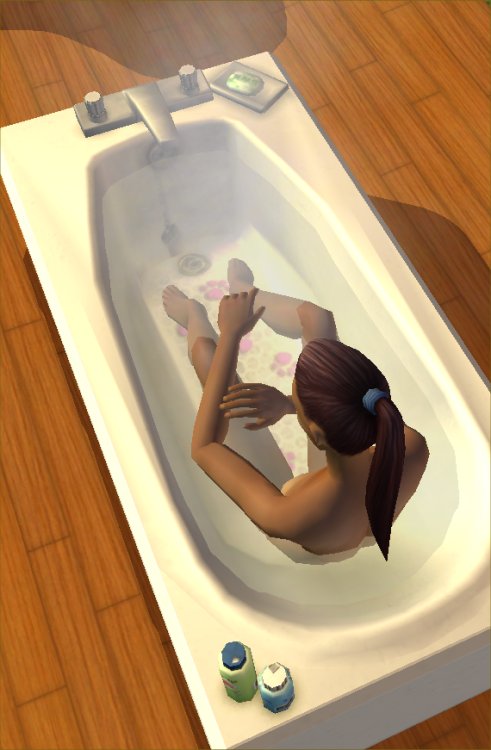

For anyone reading this who doesn’t know what the mod does, it defaults the water textures so that bath water appears as transparent.  It was originally uploaded to MTS’s sister site Sexy Sims 2 - not sure why exactly, perhaps because with it you can see the little sims’ bodies in the bath.  Personally, I like it and, if it proves to be a robust fix, I will be pleased with that.  I have not changed the file name so if you already have the mod, you can just overwrite (though you might want to back up the original just in case). I also might try some further development of the file since it is somewhat large and contains the LIFOs as well as the main textures. HL informs me on that MTS thread that the LIFOs are not needed so I might try removing them at a later date.
